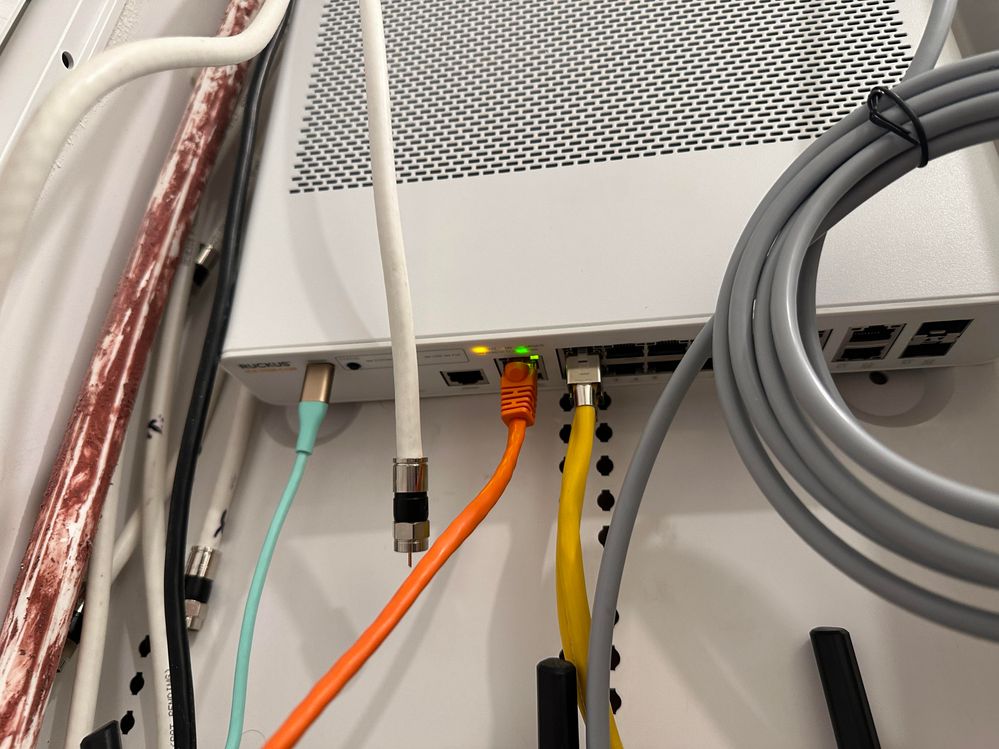

As I could see from the picture you shared, for software recovery we need to plug in 2 cables. Type-C to USB and an Ethernet cable. As you have Not used an ethernet cable it’s unable to create a connection between the Switch and the Laptop/PC. Please connect an ethernet cable and try to perform software recovery once again. Please refer to the below pictures for connection setup (Also shared in my previous post).

Do I need to separate them..? My laptop only has one usb port..Do I need to separate them..? My laptop only has one usb port..unnamed.jpg화면 캡처 2023-03-15 190751.png
