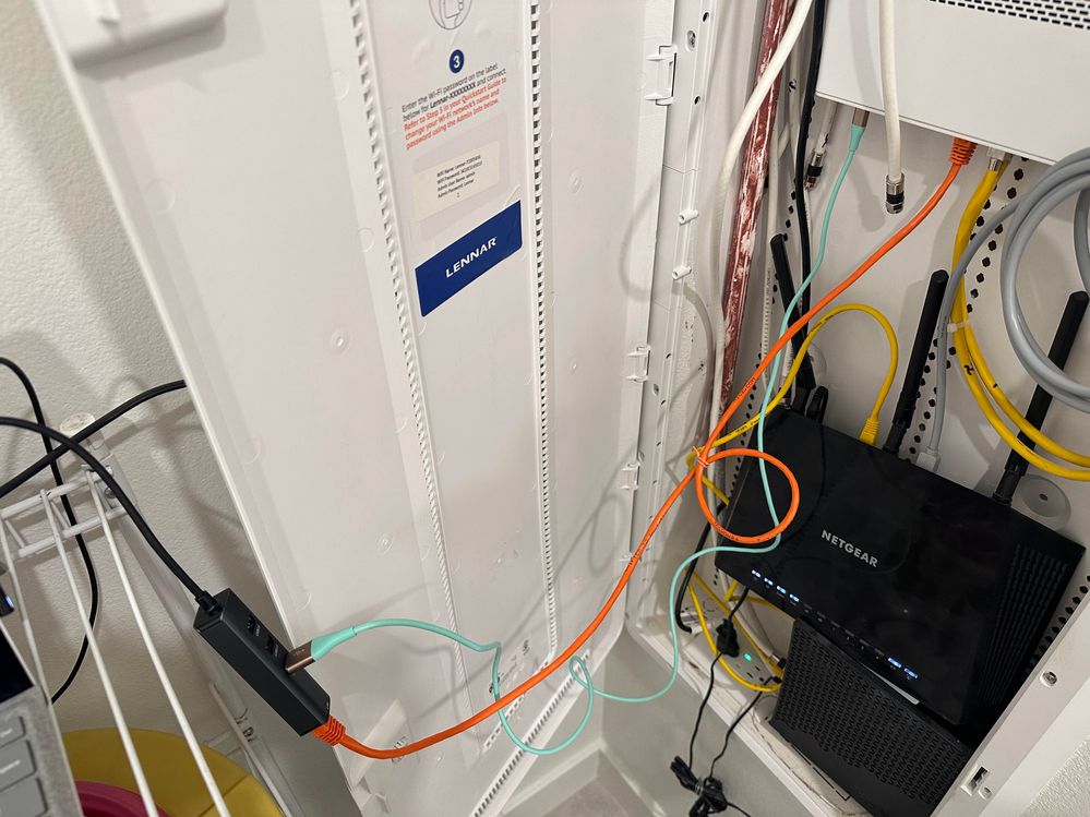

03-14-2023 10:12 AM
Hi @schu0612
As I could see from the picture you shared, for software recovery we need to plug in 2 cables. Type-C to USB and an Ethernet cable. As you have Not used an ethernet cable it’s unable to create a connection between the Switch and the Laptop/PC. Please connect an ethernet cable and try to perform software recovery once again. Please refer to the below pictures for connection setup (Also shared in my previous post).
Below are the Guide and Video Link to perform the Software recovery process:
Lennar Home Community.

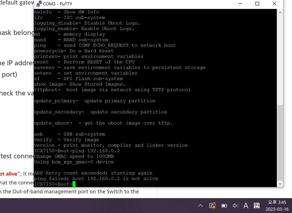

03-15-2023 07:17 PM
Hello,
When I realized that I should have used both, not just one, I thought this would work for sure.. But the result is the same. I have tried all possible server ip and I don't know what to do. It all says it is not alive.. What can I do?
Do I need to separate them..? My laptop only has one usb port..

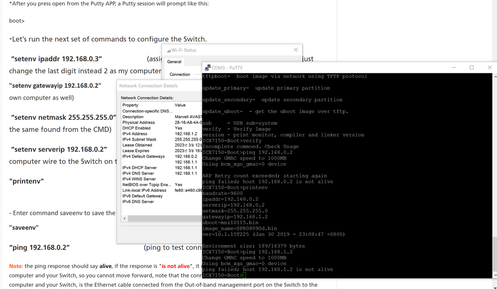

03-16-2023 08:36 AM - edited 03-16-2023 08:42 AM
Hi @schu0612
Greetings of the day!!!
Could you please configure the same IP Address for ‘serverip’ and gatewayip’ and try again (please refer to the below screenshot)? That is 192.168.0.2 or the configured IP Address as described below.
Configure the same for your computer’s IP Address for the connected ethernet as described in the Software recovery link and in the screenshot below.
03-16-2023 03:50 PM
Good afternoon,
Instructions provided in all of the posts were what I initially followed and tried.
Screenshot from yesterday was to let you know that I was also trying other IP addresses to see if it pings.
What can I try next..?
