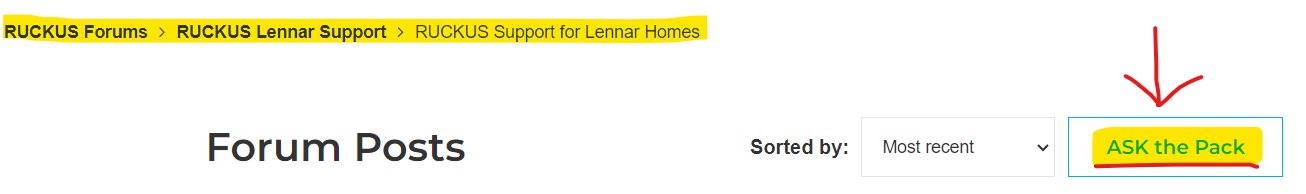

Hi @sfbravo8
Thank you for contacting the RUCKUS Community forums.
As this post is raised by @yng2019 please raise a new post with the description of your issue on RUCKUS Lennar Support
Thank you again for your understanding.
