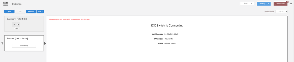

$ telnet 192.168.1.2
Trying 192.168.1.2...
telnet: connect to address 192.168.1.2: Connection refused
telnet: Unable to connect to remote host$ ping 192.168.1.2
PING 192.168.1.2 (192.168.1.2): 56 data bytes
64 bytes from 192.168.1.2: icmp_seq=0 ttl=64 time=6.351 ms
64 bytes from 192.168.1.2: icmp_seq=1 ttl=64 time=35.762 ms
64 bytes from 192.168.1.2: icmp_seq=2 ttl=64 time=19.071 msAfter resetting ICX-7150-C12p switch, I am not able to access Switch homepage and also not able to telnet to the device.
Note:
1. I am able to ping the device
2. I connected my laptop to Switch using RJ-45 Serial port.
3. I was able to connect to Switch before resetting.
03-15-2023 06:48 AM
Yes it is working and I was able to get both primary and secondary partition upgraded to 08.0.95gT211 (SPS08095g).
