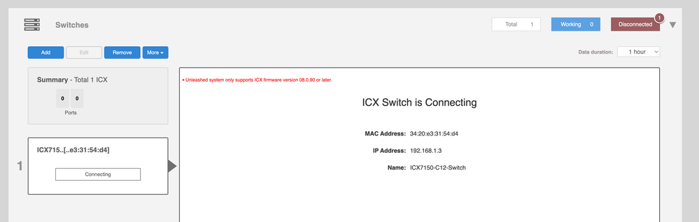

64 bytes from 192.168.1.2: icmp_seq=2 ttl=64 time=19.071 msAfter resetting ICX-7150-C12p switch, I am not able to access Switch homepage and also not able to telnet to the device.
Note:
1. I am able to ping the device
2. I connected my laptop to Switch using RJ-45 Serial port.
3. I was able to connect to Switch before resetting.
03-14-2023 03:52 PM
Still getting incorrect MAC Address.

03-14-2023 06:51 PM
It is more than 2 hours and I still getting Switch status as connecting. I am able to login to switch using same username and password with ssh.
Also, I am observing following error in Event tab on Unleashed dashboard
ICX Urgent: Device MAC:[XX:XX:XX:XX:XX:XX] reported a syslog: [ICX7150-C12-Switch Security: Console login by user User login fanterioEcssword: failed ]
ICX Urgent: Device MAC:[XX:XX:XX:XX:XX:XX] reported a syslog: [ICX7150-C12-Switch Security: Console login by user User login fanme: failed ]
ICX Urgent: Device MAC:[XX:XX:XX:XX:XX:XX] reported a syslog: [ICX7150-C12-Switch Security: Console login by user User login fan s iation failed ]03-14-2023 07:18 PM
