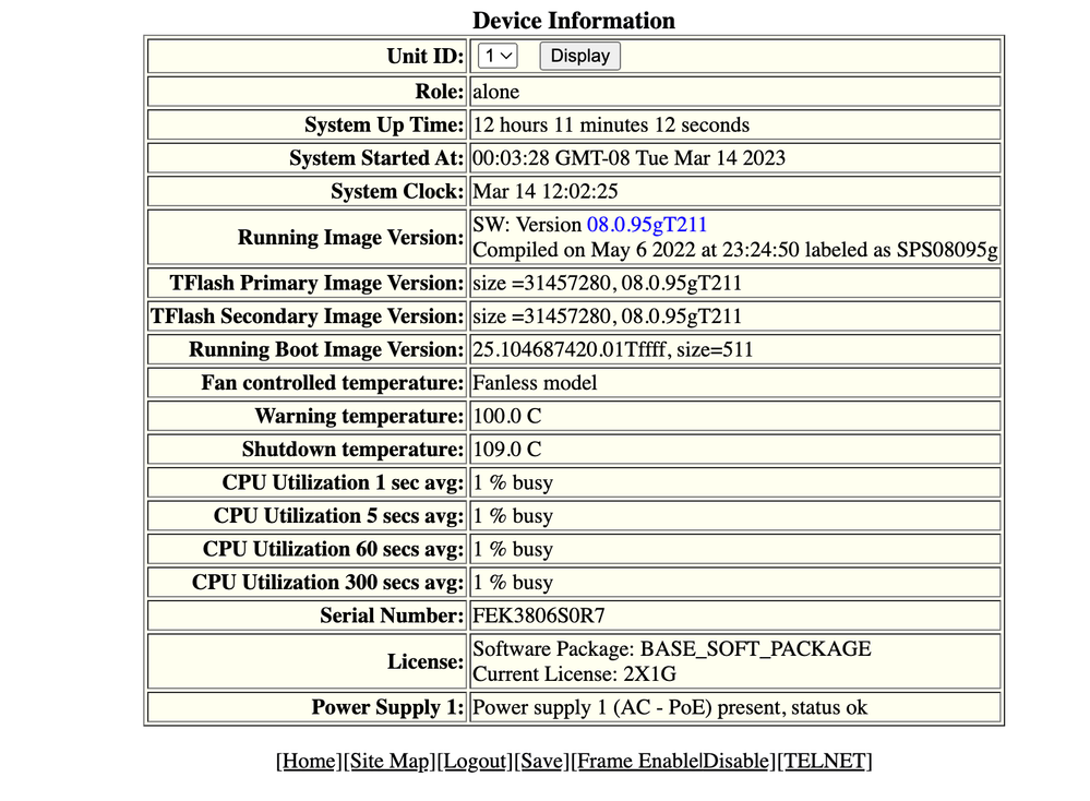

Hi Jayavidya,
current version on both primary and secondary is 08.0.95gT211 which is greater that 08090 which you mentioned.
