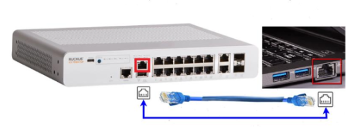

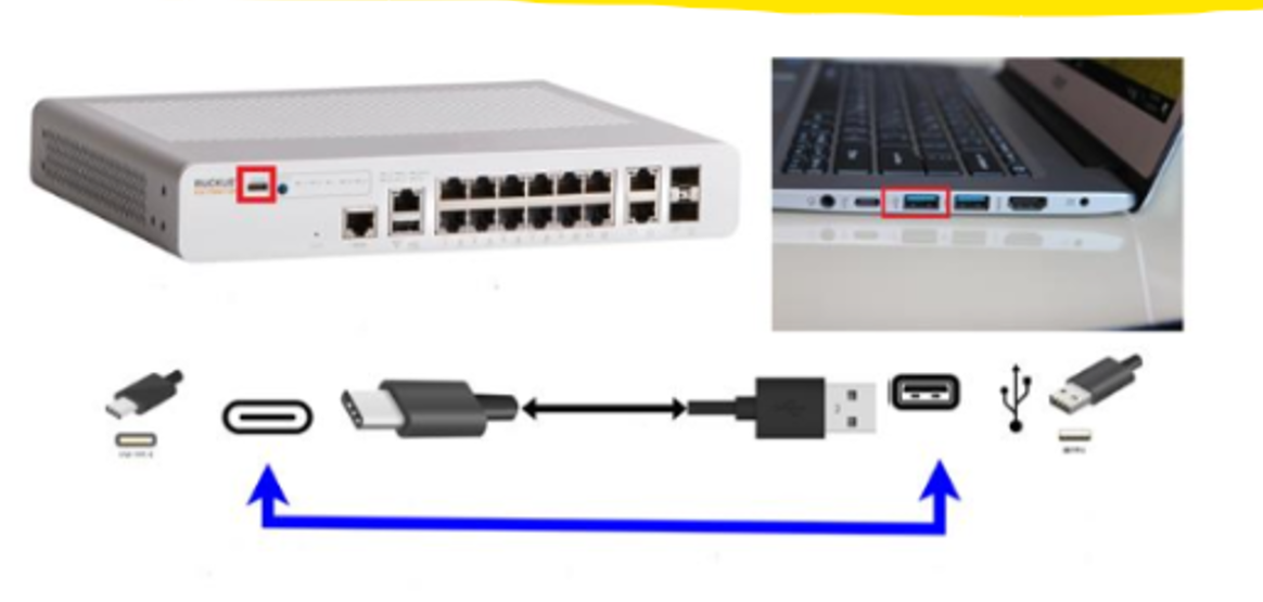

08-18-2025 07:04 AM
Hello @pgodiwala ,
Thank you for sharing the pictures.
I would request you to please share a picture showing the cable connections between the Switch and the laptop.
Please see the picture for the reference.
08-18-2025 07:09 AM
A normal company would allow for attachments in their support system. How do u want me to send u a pic without putting it on Google drive ..making a link....etc ...etc
I cannot even just do a reply email and for it to get added here....ridiuculous
