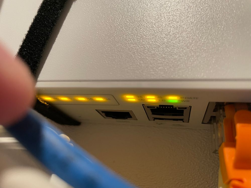

First the syst light is yellow and PWR light is green (rest of the light are off) and the access point is not power up.
I try to reset the swith by turn off the power, use a pin to press the reset button, and turn the power back on. Now all the lights are flashing yellow except the PWR is green. The first time I wait about 10 minutes, and the flashing is never stop. I turn off the power and turn back on, back to the first step syst light is yellow and PWR light is green. I tried again to reset the swith, now the lights are flashing about half hour and never stop.

As you mentioned there were lights on the PWR and SYST, if there is an amber/orange light on the "SYST" and a green light on the "PWR" on the Switch (as it is in the below picture). Meaning the Switch is stuck in the boot mode.
Basically, due to the power outage/ power spike, the switch went to a state that we call ‘boot mode’ that is not able to boot up properly. And this is the reason your RUCKUS ICX-7150-C12P Switch is unable to transmit power (PoE- Power over Ethernet) to the Access Points or on its ports.
