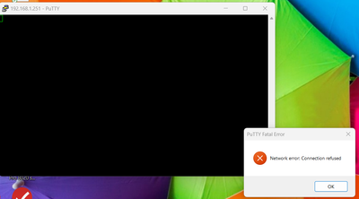

I have tried all the usernames and passwords and still nothing.  right now I cant send a screen shot because the unleashed dashboard is not working for me .  I don't `know what to do next pl
Hi @lovebirdsoffl
Could you please download the Putty Application and try to log in to the CLI using Telnet? (Please refer to the below screenshot)
Telnet – Port 23
Please let me know once you are able to login into the Telnet, I will assist you reset the username and password for the Switch. And let me know if you have any queries in this regard.
