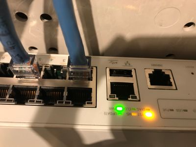

1. On your switch while it's plugged into the outlet, do you see any lights on? (Amber or green) Please let us know which lights are on. (Please refer to the below picture and share a picture of the same, showing the light status and the cable connections to the Switch ports)

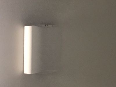

3. May I know how many Access Points are connected to the Switch? Could you please let me know the light status on the Access Points? Any of these lights are on (Please refer to the below picture and share a picture of the same)
06-23-2023 03:20 PM - edited 06-23-2023 03:23 PM
Thank you for the response. Here are answers to you questions:
1. I see only two lights. Power light is green but syst light is yellow. Please see the attached photo.
2. Internet connection is stable and working. I am using the Verizon router as wifi connection for all my devices.
3. We have three access points - one on each floor. There are no lights on any of the access points. You can see in the picture that there are no lights on the switch where the cable from access points goes in.

06-23-2023 03:40 PM
Hi @KVPRAO
Thank you for the detailed information you shared,
As you mentioned and we could see from the picture you shared, there is an amber/orange light on the "SYST" and a green light on the "PWR" on the Switch. Meaning the Switch is stuck in the boot mode.
Basically, due to the power outage/ power spike, the switch went to a state that we call ‘boot mode’ that is not able to boot up properly.
