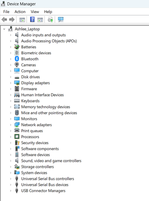

I just followed all of those steps, but there is still no Ports (COM & LPT) section in the Device Manager:

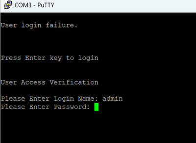

I bought a new USB to USB C cable and was able to find the COM port details (mine is COM3). I then opened Putty and configured Putty like this:
Then I selected "Open" and saw only this (with no writing at all):
When I hit "enter" I see this, and then it freezes and does not allow me to enter a password (also, I'm assuming my username and password for this should mirror the one for my Unleashed account?):

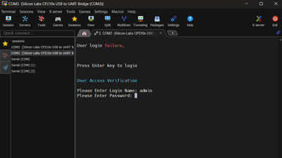

I have the same issue when I try from MobaXterm:
