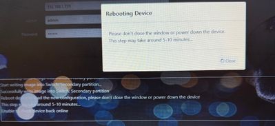

Ive been on this page for over an hour saying rebooting device

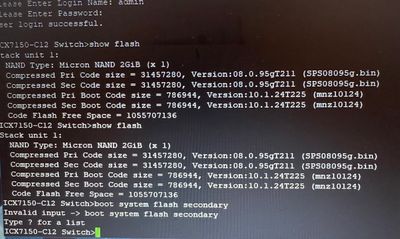

Here is a photo from putty showing flash while it is on the upgrade reboot?
Hello @Cjessee ,
From the response shared, I see that the Switch is on the latest recommended version 08.0.95g.
Also, the Switch is on the Switching code as it should be.
May I please know if the Upgrade tool still shows as rebooting?
Thank you for your patience and understanding,
Good to know it is updated now. I eventually closed the update tool and was able to log in successfully. Is there a newer firmware version than the 08.0.95g? How do I do future updates so that it is on the most current firmware?
