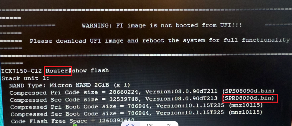

Hello @Cjessee ,
From the below screenshot you shared, I understand that the Switch is booted up on the secondary partition which is running on Routing code (SPR)
The Switch should run on the Switching code (SPS) to avoid these issues for Lennar home users. Due to a power outage/power spike, the Switch boots up on the other partition which may be running on a ‘Routing Code’ results in causing this issue.
Please follow the below RUCKUS Lennar Knowledge base self-help article which will help you to fix the issue when the Switch is running in the Routing code.
Please follow the process as explained in the article and let me know if you have any queries in this regard.

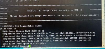

08-11-2025 12:33 PM
There was one line that showed SPR. I followed the prompts you sent me to change to sps. One I followed the commands the ruckus just went back into bootloader mode and would not start back up?

Hello @Cjessee ,
Thank you for sharing the pictures.
I understand that the version on the Switch is 08.0.90d.
We recommend transitioning to version 08.0.95g, identified as the stable version for Lennar Home users.
To facilitate this transition, we have recently introduced an upgrade tool tailored to ensure a seamless process. Utilizing this tool is straightforward: users simply need to input the IP Address, Username, and password associated with the Switch into the software interface.
