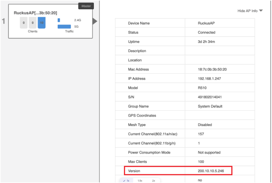

My Sonos Playbar is operating on 2.4 GHz no longer connects to my Rukus ICX7150, Serial number ***********.

Hi @rmwass
Based on the screenshot provided, I see that your RUCKUS Unleashed system is still running an older firmware version (200.10.10.5.246)
We recommend upgrading the Unleashed system to the latest recommended version and then attempting to connect your SONOS devices again.
Please refer to the RUCKUS Lennar Knowledge Base self-help article below for detailed instructions on the upgrade process:
https://community.ruckuswireless.com/t5/RUCKUS-Lennar-Support-Knowledge/RUCKUS-Unleashed-Access-Poin...
Kindly let me know how it goes, and feel free to reach out if you need any assistance during the upgrade process.
04-14-2026 05:02 AM
So I should select 200.15.6.212.27 from the drop-down list for the online upgrade, not the one that is highlighted, 200.10.10.5.253.

04-24-2026 12:24 PM
It looks like the firmware has been updated, and now my Sonos is working. Does it mean that Ruckus can detect 2.4Ghz and 5Ghz? How do I see that in Unleashed?
