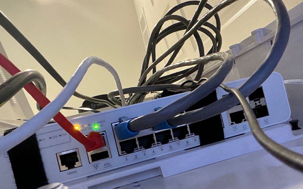

04-16-2026 03:20 PM
Thank you for your quick reply. I have attached a picture and both green/amber lights are solid and that’s all that is happening. No outward power is running from any port or the items that need to be using this router. No power running to either extender also from the power outage.
04-17-2026 05:40 AM
Hi @Logan11
Based on the image you shared, the RUCKUS switch is showing an amber SYST LED, which typically indicates that the switch is stuck in boot mode.
To further understand and troubleshoot this issue, please refer to the RUCKUS Lennar Knowledge Base self-help article below:
https://community.ruckuswireless.com/t5/RUCKUS-Lennar-Support-Knowledge/Fixing-RUCKUS-Switch-with-an...
Kindly follow the steps outlined in the article and let me know if you need any assistance at any point during the process, I’ll be happy to help.
