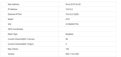

Please find below a screenshot of the requested information.
Hi @cwillis
Based on the screenshot you shared, I noticed that your Access Points are currently running an older firmware version: 200.7.10.2.339. This version must be upgraded before proceeding with further configuration.

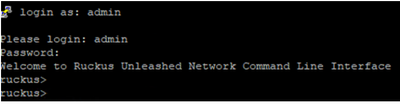

Here’s an example of PuTTY command line output from my lab for reference: (Bold fonts are commands to execute)
login as: admin
Please login: admin
Password:
Welcome to Ruckus Unleashed Network Command Line Interface
ruckus> en
ruckus# config
You have all rights in this mode.
ruckus(config)# wlan "Your Wi-Fi Name"
The WLAN service 'Your Wi-Fi Name' has been created. To save the WLAN service, type 'end' or 'exit'.
ruckus(config-wlan)# no qos directed-multicast
The command was executed successfully. To save the changes, type 'end' or 'exit'.
ruckus(config-wlan)# qos directed-threshold 0
ruckus(config-wlan)# end
The WLAN service 'Your Wi-Fi Name' has been updated and saved.
Your changes have been saved.
ruckus(config)# end
ruckus# ap-mode
ruckus(ap-mode)# set qos directedDHCP disable
Direcet DHCP is Disabled
OK
ruckus(ap-mode)#
