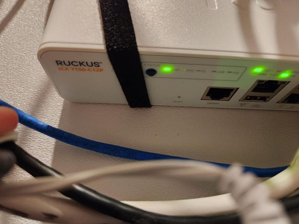

I've got to the port step before boot and recover software. Unable to connect to port between switch and laptop. Ive made sure the ethernet cable is plugged into slot 13 and plugged into the laptop. When seach through the device manager for the com port number. When I go to Putty and change the port to the com port number it wont connect. Any ideas?

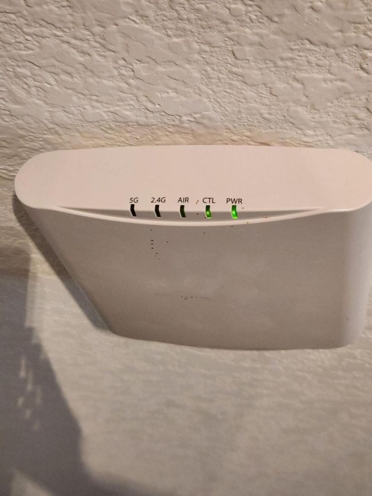

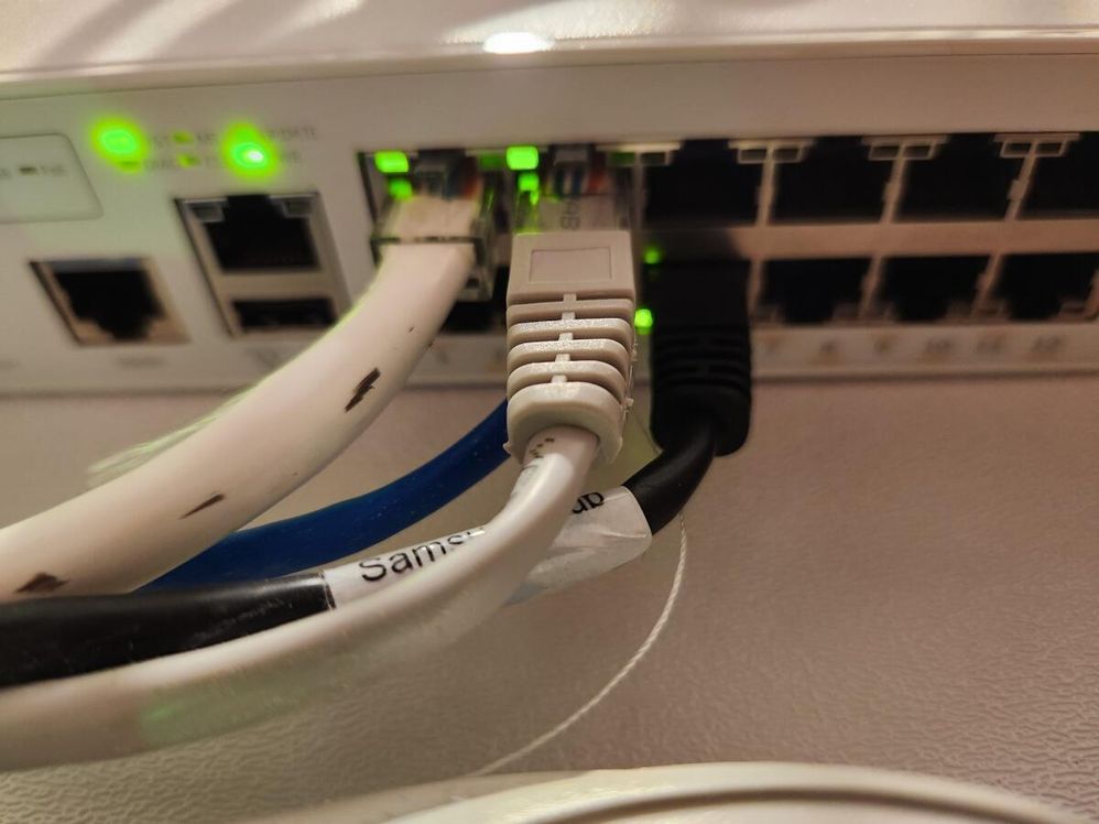

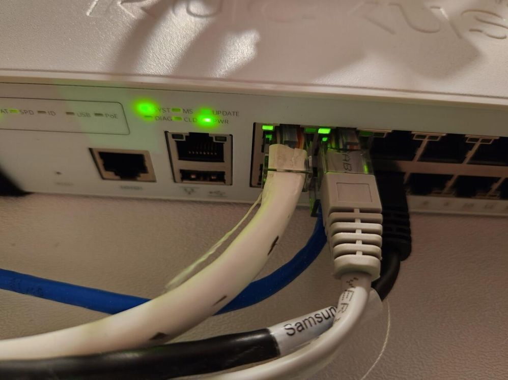

White is POE, Grey goes to the Router
Black goes to the SmartThings
Access Point

As per the light status of the Switch and the Access Points, they seem to be normal in behavior. As 2.4G and 5G, lights are Off meaning your Access Points are not getting the IP addresses from your ISP (Internet Service Provider) local router. (Please refer to the below link for the same)
We suggest you check the internet connectivity by your ISP side (Internet Service Provider). Could you please connect the Ethernet cable to Switch and your Laptop or a PC and Router to Laptop or a PC and confirm the internet connectivity? (Please refer to the below pictures).
Also please try to unplug the cables and plug in different ports on the Switch within 12 ports as shown in the below screenshot. And check the behavior.
