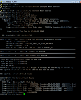

This issue is because your switch is running on the Routing code (SPR). The Switch should run on the Switching code (SPS) to avoid these issues for Lennar home users. Due to a power outage/power spike, the Switch boots up on the other partition which may be running on a ‘Routing Code’ results in causing this issue.
As I can see from the output you shared, your Switch is booted up on the secondary partition which is running on Routing code (SPR) as highlighted in the below screenshot.

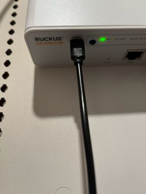

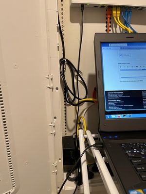

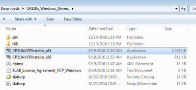

I’m using a Mac to connect. I installed the drivers in the guide. I connected the usb/usbC from the Mac laptop to the ruckus switch. I opened the Mac terminal and entered command ls /dev/cu.* but that returned /dev/cu.Bluetooth-Incoming-Port and nothing about /dev/cu.SiLabs_Serial like the guide said. So when I enter the command screen /dev/cu.SiLabs_Serial 9600 the terminal says there’s no such file or directory and I can’t move past this step.

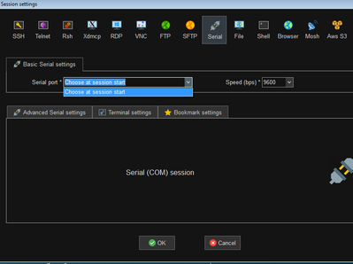

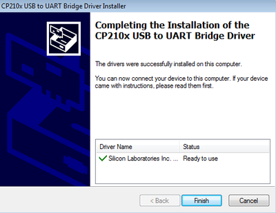

Hello - I tried on a Windows 7 OS laptop and once again it does not work. I installed the USB drivers and installed PuTTY and mobaxterm. I cannot find any USB on COM in Device Manager and mobaxterm does not recognize any USB on COM.
I greatly appreciate your time and help, but this has become very frustrating. I've dedicated many hours of my time over several days and have made no progress.  If we can't get this fixed tomorrow I'll need you guys to send someone out to my house to fix.

Please use Putty Application with Silicon Lab COM port. And, please share a screenshot of the device manager showing the COM port information.

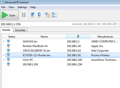

I decided to log my laptop directly into the router instead of the switch and try Advanced IP Scanner again. Miraculously, it has detected an IP address for ICX7150-C12-Router.lan. I tried the SSH method in PuTTY again and I got in. Please see screen shots below for command outputs! Please advise next steps.
