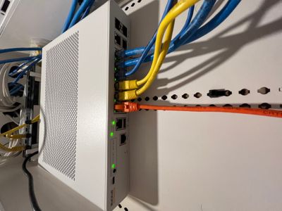

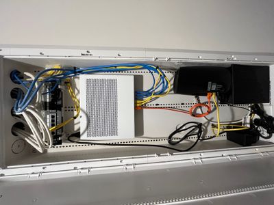

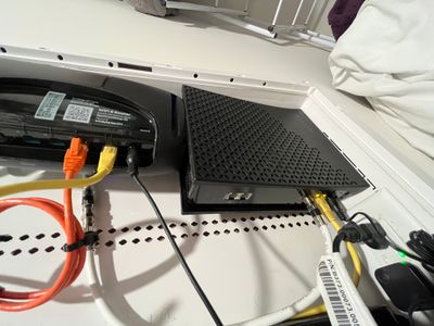

To check further, could you please share a picture of your RUCKUS ICX-7150-C12P Switch showing the light status and the FULL Switch panel cable connections to the Switch ports? (Please refer to the below picture)
08-14-2023 12:11 PM

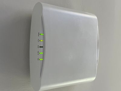

Ok, thanks. I’m attaching your requested pictures and both of my access points on the ceilings. please let me know if you need more pictures.

Hi @ckal9
Thank you for the response and for sharing the requested pictures.
All the ethernet cable connections seem good.
Could you please reboot (unplug and plug from the power outlet) your Switch and ISP (Internet Service Provider) Router once?

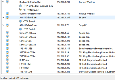

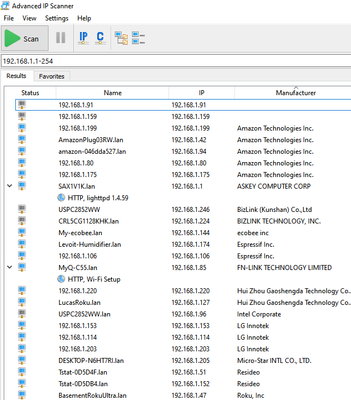

08-14-2023 01:51 PM
I unplugged modem, router, ruckus, and plugged back in, waited about 5 min, then ran Advanced IP Scanner again. I only see the same two Ruckus Wireless IPs as before, nothing with ICX or Brocade. Added screen shots below.

Hi @ckal9
If you are unable to get the IP address of the Switch, the only option left is to get console access to the Switch-
Here is a guide on how to access to the Switch via console (cable access between your PC to the ICX 7150-C12P) in this case we need a USB type C to USB standard or Console cable Rj45 to USB.
