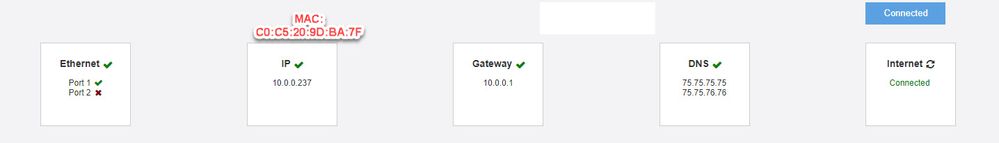

My internet connection though Ruckus is getting very slow speeds and cutting out for over a month now. I have researched for hours on here and I have been trying to trouble shoot using this forum with no luck so far.
Under rogue devices in the dashboard I can see all of my neighbors WIFI's being listed to mark as known or malicious. I also see the internet name connected to my Xfinity router listed on here trying to connect to my AP's.
When I bought my home I was advised I can manage everything through my app. I have used google chrome PC to check the dashboard and I do not have access to another computer looking at these steps it seems I need access to a different type of PC to troubleshoot my possible switch issue?
I am not sure how to verify the Mac address matches the IP Address that is currently set to manual on the dash board. On the Ruckus router there is a sticker that is listed the MAC address provided but I am not sure if this is to this same IP address.
Thanks.
