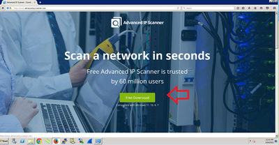

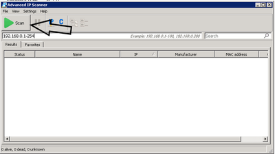

You can run the IP scanner by using the following applications to check the IP address for Telnet/SSH or web access to the Ruckus devices.
Windows:
https://www.advanced-ip-scanner.com/
NOTE: IMPORTANT VIDEO TO WATCH https://youtu.be/O1lerd0IFg0
Apple:
1-https://apps.apple.com/us/app/lanscan/id472226235?mt=12
2-https://apps.apple.com/us/app/ip-scanner/id404167149?mt=12
Video as reference : https://www.youtube.com/watch?v=vD7KLR8u1EM
iOs or Android option
https://apps.apple.com/au/app/fing-network-scanner/id430921107
Video Reference : https://www.youtube.com/watch?v=gWdarROXBmI

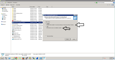

1 ) Downloads the application
2 ) Proceed to install (it can be portable ‘does not need to be install’ or install.exe that install the app in your computer)
3 ) Once is installed (open the app) and then click the Start bottom to star running the scanner

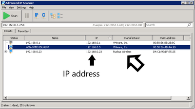

4 ) Ruckus devices are going to be detected as Ruckus Wireless / Ruckus Switch / Ruckus Router / unleashed as the shown example:
Video link as reference: https://www.youtube.com/watch?v=0zxgUn_Tm08

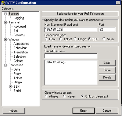

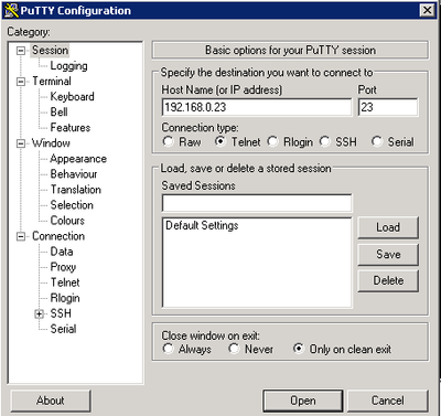

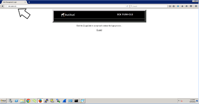

5 ) Since we already know the IP for the Ruckus switch (192.168.0.23) , I can access to the switch via Web/ssh/telnet
Webb access example :
SSH example:
Telnet example :

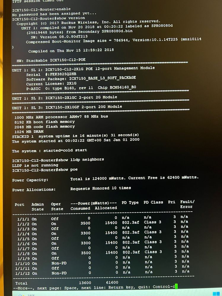

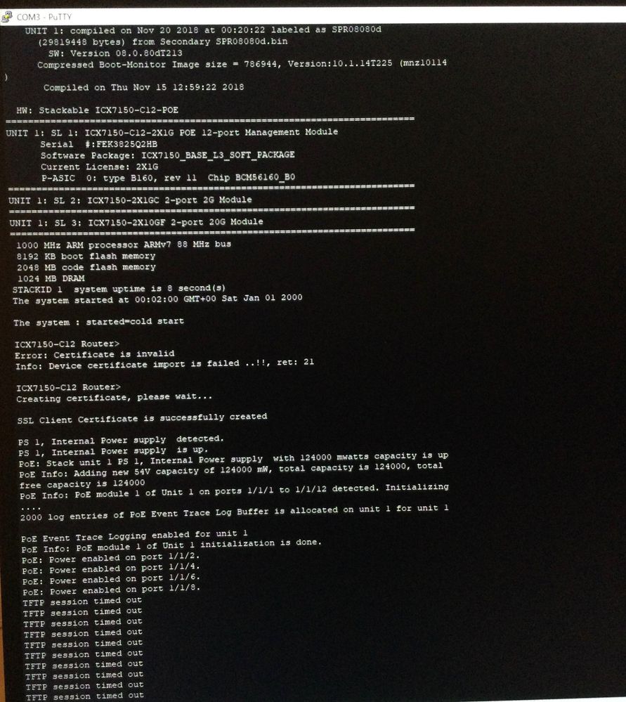

I was able to locate the switch IP.
I am not sure what code I need to run. Please see results attached.Ruckus manually unpluggedRuckus manually unpluggedcommand resultscommand results

As I can see from the screenshots you attached
 I see your Switch is running  routing code, this code is not recommended for Lennar home users as it creates connectivity issues like the following examples:
-Slow connectivity
-Smart devices like Amazon's Alexa not working as intended.
-Websites not loading.
-Several connectivity issues.
To fix this issue is quite simple since you already have access to the switch.
Using the above commands that I will list, this will fix the issue permanent the ‘routing code issue’, as we will delete the second partition and put the correct partition in its place  ‘SPS’ .
As we can see the Switch has the Routing code in the second partition 'SPR'08080d.bin
Commands that you need to run:
Enable
Copy flash flash secondary
Example:
>enable
#copy flash flash secondary
What the switch will do is copy the correct image, which is SPS'08080d.bin, in the secondary partition, which will permanently eliminate the routing code. We must wait for the process to finish.
Once the Switch completes the process, we must restart to start running the correct code
#boot system flash primary yes
Here is a short video for demonstration how to to fix this issue ‘ Routing code ‘
VIDEO LINK AS REFERENCE:https://www.youtube.com/watch?v=Eem1IBgYaWc
