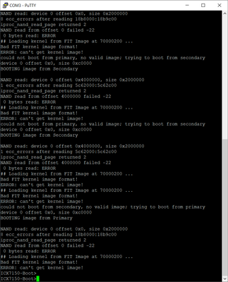

When I power up only the SYST (yellow) light and the pwr (green) light is lit. I have done a hard reboot and total reset and nothing works. When I hold the reset button in and power up all the light flash once and the STST (yellow) light and the pwr (green) light stay on and when I release it does the same thing. What else can I try to get this to boot?

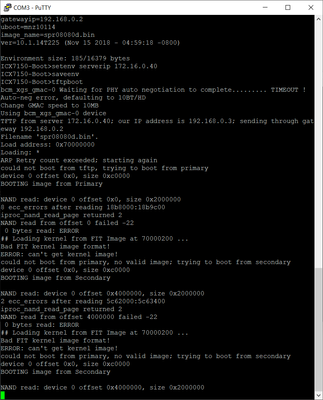

Please use the same IP Addresses and use Putty.

Could not boot from tftp….do i need to change the server up to the address of the computer

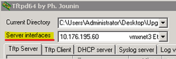

Hi @sckoshe
Thank you for the update.
Please try to use different IP addresses from the Server Interfaces of the TFTP. (Please refer to the below screenshot)
Thank you again.
