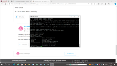

I was able to get into the switch using putty. was able to reload the flash, however it comes up as a router. at the switch command line it now says. "ICX7150-C12 ROUTER
dont know what to do now?
