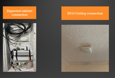

Can you confirm what of the Ruckus component you are referring too, you may have a ICX 7150 Switch that must be in a cabinet and 1 or two Access Points that must be on your ceiling, Please provide a picture.
Left one will be the Switch and the one on the ceiling is the Access Point, important the ICX 7150 Switch is the one that provides power to the Access Points on the ceiling.
