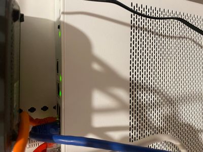

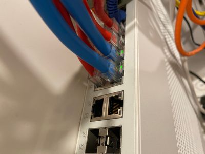

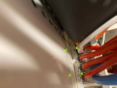

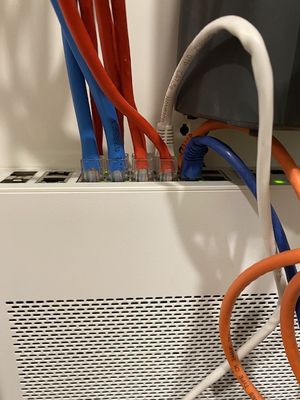

2. On your switch while it's plugged into the outlet, do you see any lights on? (Amber or green) Please let us know which lights are on. (Please refer to the below picture and share a picture of the same, showing the light status and the FULL Switch panel cable connections to the Switch ports)

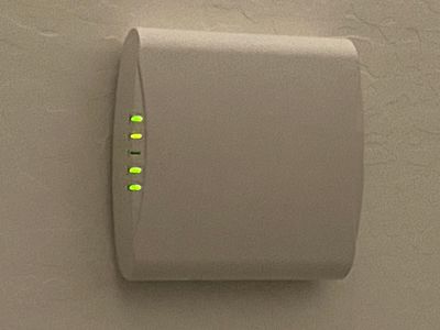

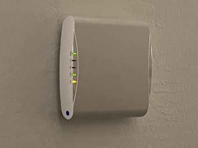

3. May I know how many Access Points are connected to the Switch? Could you please let me know the light status on the Access Points? Any of these lights are on (Please refer to the below picture and share a picture of the same)
Please let me know the answers to ALL the above queries or let me know if you have any queries in this regard.
01-09-2024 05:45 PM
Hello,
01-10-2024 04:58 AM
Hi @5476Stacy
As per the light status of the RUCKUS ICX-7150-C12P Switch and the Access Points, they are in a normal state. We may need to check some Switch configurations to troubleshoot this issue.

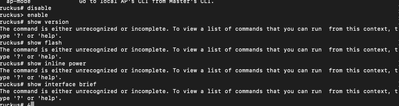

Please follow the below steps and help us with the queries:
ICX7150-C12 Router> OR
ICX7150-C12 Switch>
show version
show flash
show inline power
show interface brief
01-10-2024 06:17 PM
Hello,
I followed your instructions, but the commands don't seem to be working. Please view screen shot below-
Please advise-
Stacy
