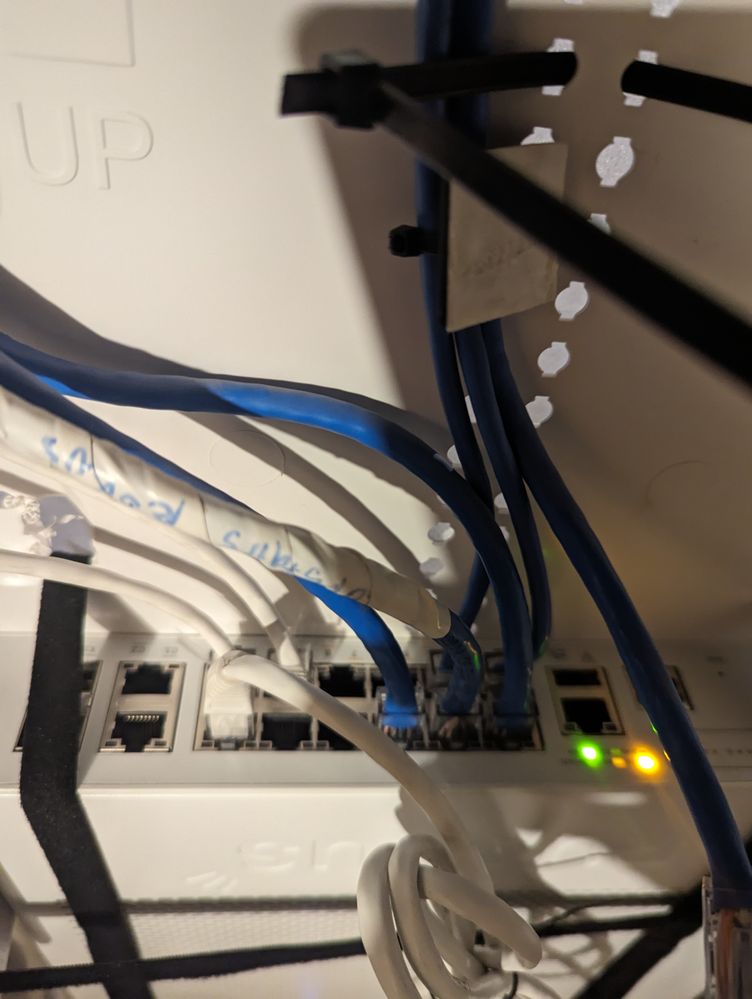

2. On your switch while it's plugged into the outlet, do you see any lights on? (Amber or green) Please let us know which lights are on. (Please refer to the below picture and share a picture of the same, showing the light status and the FULL Switch panel cable connections to the Switch ports)

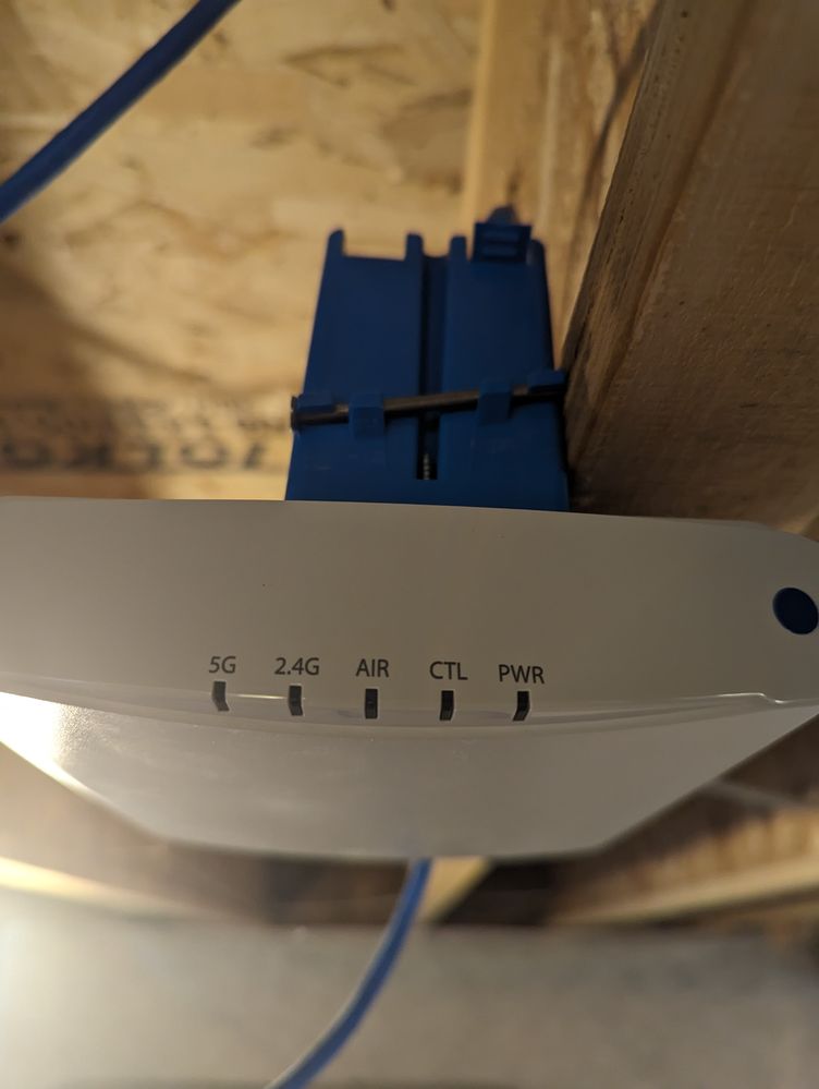

3. Could you please let me know the light status on the Access Points? Any of these lights are on (Please refer to the below picture and share a picture of the same)

2) PWR is green, SYST is amber, all other lights are off. This changes once the system reboots though.
3) There are no lights on the APs. This also changes after the system reboot though.

As you mentioned and we can see from the picture you shared, there is an amber/orange light on the "SYST" and a green light on the "PWR" on the Switch (as it is in the below picture). Meaning the Switch is stuck in the boot mode.
Basically, due to the power outage/ power spike, the switch went to a state that we call ‘boot mode’ that is not able to boot up properly.
First, we will try to reset the Switch as described below:
  • Remove power from the switch.
  • Press and hold the Reset button while applying power to the switch.
  • After all the system LEDs flash amber, release the Reset button.
IF RESET IS NOT WORKING, PLEASE TRY TO RESET YOUR SWITCH MULTIPLE TIMES (Like 10-15 times) AS DESCRIBED ABOVE.
