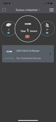

why is my switch still red on the app?
Hi @relingburg
It will take some time to get the Switch synchronize with the Access Points/Unleashed. Kindly check after some time.
Thank you again.
Lennar Home Community.

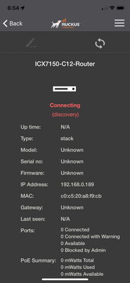

it’s been 12 hours… it still says connecting on the app, and is labeled as “router.” how long does it take to sync?
Hi @relingburg
Thank you for the response and update.
As your Switch is showing as pending/connecting it could be for multiple reasons, (Please refer to the below picture)
Please follow the below steps to get Switch in sync with Unleashed. We will delete the Switch from Unleased and Add it back.

1- Remove the existing Switch from the Unleashed (Please refer to the below picture):
2-Hit Add on that dashboard
3-Put the IP address of the ICX switch (ICX-7150-C12P) and Password– If you don’t know the IP Address of the Switch. Please perform the below command from the Switch CLI to get the same.
Device>enable
Device#show ip address
4-Username and password for Switch authentication are the same as what you use to log in for Switch on Web or CLI (Putty).
https://docs.commscope.com/bundle/unleashed-200.9-onlinehelp/page/GUID-30C6694A-6AEE-4DF8-9459-1AB18...
To sync the data, it will take us a while, so after a couple of minutes, it should say connected.
Once the Switch gets synchronized, please check the dashboard again.
