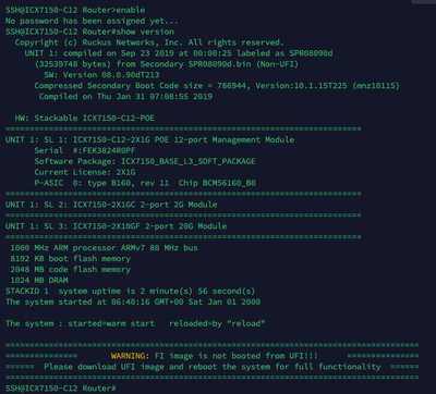

ok...so I got access to the switch CLI and it seems it has booted off the wrong partition.
So I started the sequence of commands that you have posted before, but I get the following error

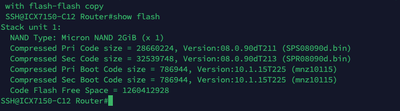

I've also attached the show flash command as well.
Any ideas what I'm doing wrong?
- Mark as New
- Bookmark
- Subscribe
- Mute
- Subscribe to RSS Feed
- Permalink
07-20-2023 08:41 AM
Hi @Cbaddy
Please enter below commands and try.
reload (This command will reboot the Switch)
y (Wait until the Switch comes up after reboot and restart Putty, perform next commands)
copy flash flash secondary
