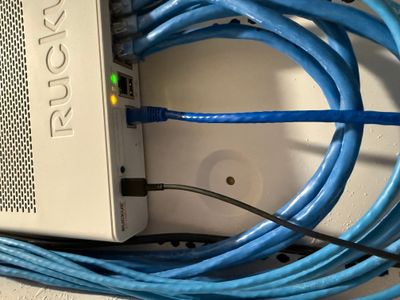

35 to 40 times? I tried about 5 times and no luck. Everytime I do the reset it goes back to the Amber and green light as shown in the image below. I am also attaching the image of the usb to type c connection from laptop to switch

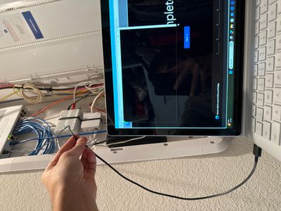

06-30-2025 09:35 AM
here is a clear photo of laptop connected to switch and the putty stuck on boot mode

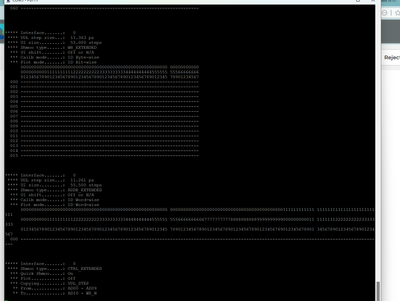

06-30-2025 09:45 AM
Now PUTTY is continuously just churning commands such as below, how even I am unable to type any new commands>>

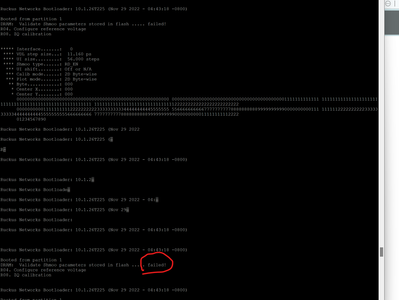

06-30-2025 09:59 AM
Another screen shot of PUTTY, as you will see it says something sbout "Flash" being "failed". Also at this point I have pressed the hard reset button with paper clip over 40 times

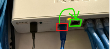

Hi @Amulyabhat
Thank you for your response and for sharing the information.
Based on the image you provided, it appears that one of the Software Recovery cables is connected to the incorrect port on the RUCKUS switch.
Please refer to the screenshot below and ensure the cable is connected to the correct port.
Once corrected, kindly restart the Software Recovery process from the beginning.
Please let me know how it goes.
