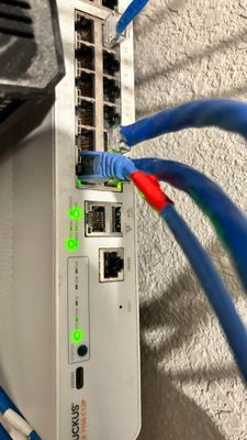

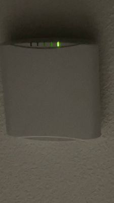

Our ruckus just went offline couples of days ago. We need support for CX7150-C12-Switch
9 REPLIES 9
1. System has been working for a few years but the switch was replaced by Ruckus about a year ago, similar issue this time.
2.  Input and outputs to 2 access points are green, but none for other LAN outputs
3. Yes working fine.
4. 2 access points, 2 green lights, but second light blinking one 1 unit.
No power outage recently.
Hi @Darksilver
As per the pictures you shared, Switch seems in a normal state.
We may now need to factory reset the APs. Please follow the below process to factory reset your APs to configure them with a new SSID.
IMPORTANT NOTE: To perform a factory reset correctly on one of the access points, you must disconnect the rest of your other access points from the "ICX-7150-switch". For example, if you have 3 access points, you should go to the switch and disconnect 2 of the cables to turn off the "2 access points" and only leave 1 connected with which we are going to work the factory reset once you configure the access point and make sure all is good, go ahead and reconnect the other Access Points back.
As you have 2 Access Points in your case, remove the cable of any one Access Point, and perform the factory reset on the other connected access point and once you complete it, connect the unplugged Access point back to the Switch.
