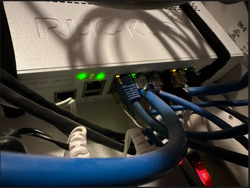

Every couple days the RUCKUS device loses power, but if I unplug and plug back in, lights return and everything is on/back to normal. It happened this morning when I woke up and just happened for the first time during the day while using the internet, so it is becoming more frequent.
Started maybe a week or two ago, possibly after a power outage.

Hi @kdaytime
Could you please let me know which cables you unplug/plug and it starts working? Is it the main power cord of the RUCKUS ICX-7150-C12P Switch or ethernet cables from the Switch ports?
If ethernet cables, could you please let me know if it is only a specific one or all the ethernet cables?
Also, could you please log into the CLI and share the outputs of the below commands?
show inline power
show interface brief
10-20-2023 10:44 AM
The main power cord is what I unplug/plug in. Haven't touched any other cables.

10-20-2023 11:59 AM
Hi @kdaytime
Thank you for the response and for sharing the requested information.
As the ports are working fine for other network cables, the 1/1/9 port on which an Access Point is connected is only able to transmit 100 Mbps of speed (please refer to the below screenshot) which is a result of a defective network ethernet cable. This issue/problem maybe more on the cable side, we suggest you check the ethernet cable connected to the 1/1/9 port. You could try to unplug/plug it into any 1 in-12 ports as highlighted in the 2nd screenshot below and check the ‘show interface brief’ command if it is able to transmit 1G speed. If that doesn’t work, please replace the ethernet cable with a new/working cable and try again.
10-20-2023 12:10 PM
So you are telling me an ethernet cable could make the power shut off on the whole switch? That doesn't make sense.
10-20-2023 12:12 PM
Do you think I need to purchase a new switch?
