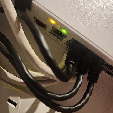

1) On your switch while it's plugged into the outlet, do you see any lights on? (Amber or green) Please let us know which lights are on. (Please refer to the below picture and share a picture of the same, showing the light status and the FULL Switch panel cable connections to the Switch ports)

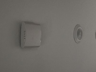

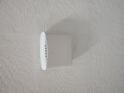

2) May I know how many Access Points are connected to the Switch? Could you please let me know the light status on the Access Points? Any of these lights are on (Please refer to the below picture and share a picture of the same)

PWR light is solid green
SYST light is solid orange
Have 2 access points, both have no lights on

Hi @Brian_13 ,
From the pictures you shared, I understand that the status lights on the Switch is Amber and the PWR light is Green which means that the Switch is stuck in the boot mode.
