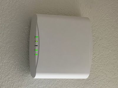

4. My apologies. I loaded the same picture twice
upstairs
Hi @Overlook19
As per the light status of the RUCKUS ICX-7150-C12P Switch and the R510 Access Points, they seem to be in a normal status.
As I see from one of the pictures you shared, seems like the ethernet cable which is coming from the ISP’s (Internet Service Provider’s) Router or Modem/Router combo is plugged into the wrong port on the Switch panel. It must be plugged into any 1 in-12 ports as shown in the below screenshots. Please unplug the ethernet cable, plug it into the correct Switch port, and reboot (unplug and plug from the power source) your RUCKUS ICX- 7150-C12P Switch and ISP Router once try to connect to the Internet via Access Points to check the speed.
Please confirm and let me know if you have any queries in this regard.
