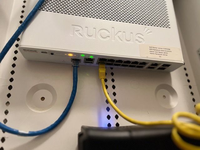

  2. On your switch while it's plugged into the outlet, do you see any lights on? (Amber or green) Please let us know which lights are on. (Please refer to the below picture and share a picture of the same, showing the light status and the FULL Switch panel cable connections to the Switch ports)

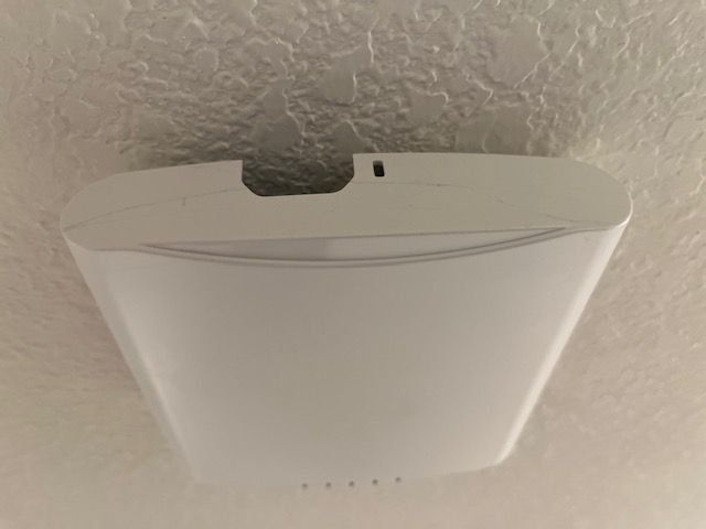

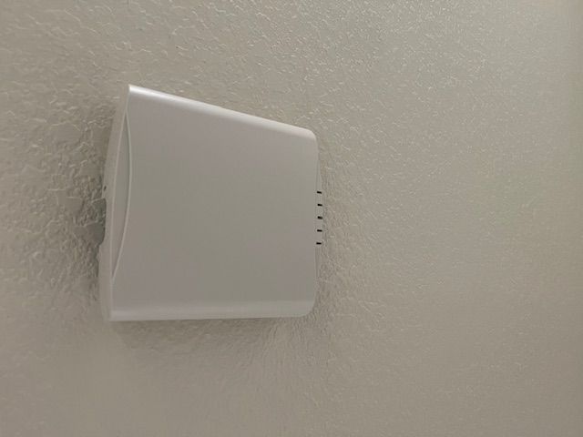

     4. May I know how many Access Points are connected to the Switch? Could you please let me know the light               status on the Access Points? Any of these lights are on (Please refer to the below picture and share a                      picture of the same)

2. Yes, there is a amber colored light and 2 green lights.
3. Yes, switchswitchaccess pointaccess pointaccess point picture 2access point picture 2my Internet is stable and working
4. There is one access point connected to the switch, and none of the lights are on.

As I see from the picture you shared, seems like the ethernet cable which is coming from the ISP’s (Internet Service Provider’s) Router or Modem/Router combo or Access Point is plugged into the wrong port on the Switch panel. It must be plugged into any 1 in-12 ports as shown in the below screenshot. Please unplug the ethernet cable, plug it into the correct port, and reboot (unplug and plug from the power outlet) your RUCKUS ICX-7150-C12P Switch once. Then Check if that works.
