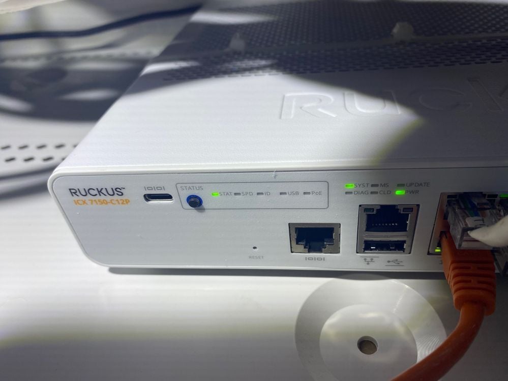

The switch is a ICX 7150-C12P. The lights that are on are the Port Link Status, System Status and Power. All are green.
On the APs, the Pwr, 2.4G and 5G lights are green. Sometimes the CTL is green.

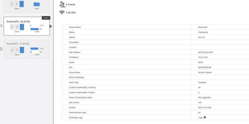

07-20-2023 11:07 AM
Here are the configs of both APs
