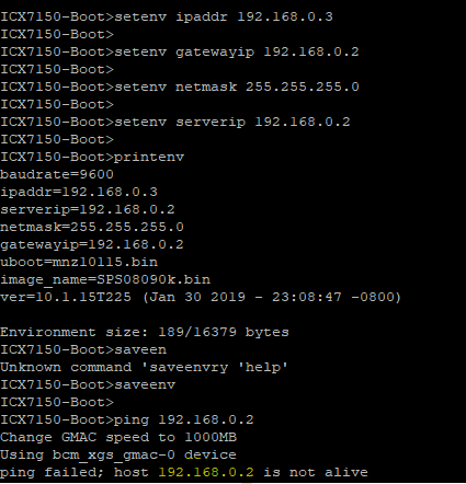

Based on the troubleshooting done, your ICX-7150-C12P Switch is stuck in boot mode and you tried hard resetting and Software Recovery. However, the failure persists. This Switch unit Should be RMA (Return Merchandise Authorization) in simple words replacing it.

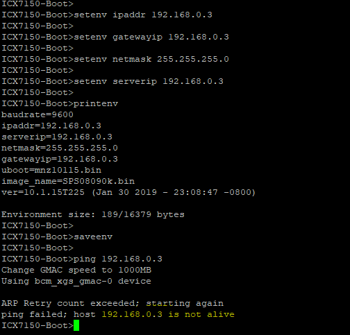

did this step and it said gateway was not alive. changed ip to end in 3 and same issue

Hi @RobertCostigan
If you are getting a 'not alive' error please refer to the RUCKUS Lennar Knowledge Base self-help article to fix it.
Please let me know how it goes.

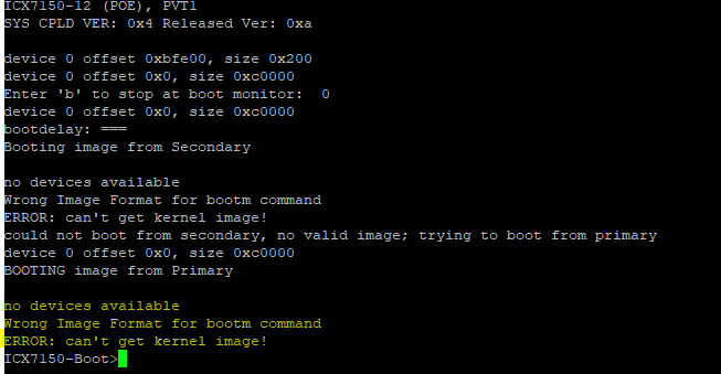

01-09-2025 09:00 AM
removed the firewall and it stated "alive" which allowed me to proceed forward. however when i went through the rest of the steps it was stating no device available:
