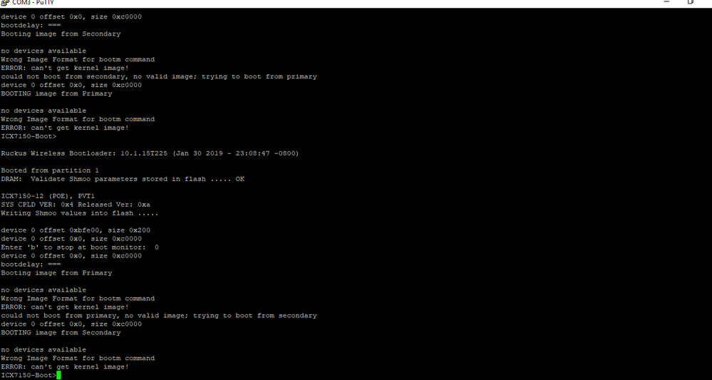

Based on the troubleshooting done, your ICX-7150-C12P Switch is stuck in boot mode and you tried hard resetting and Software Recovery. However, the failure persists. This Switch unit Should be RMA (Return Merchandise Authorization) in simple words replacing it.

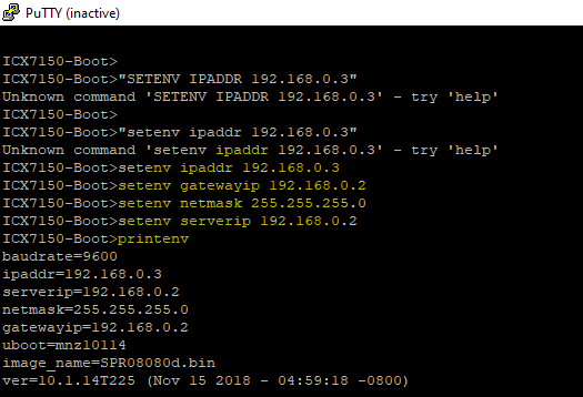

yes i configured through the steps, please see below:

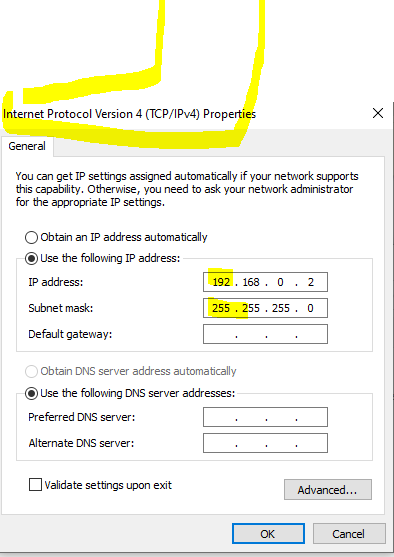

Could you please share the below screenshots of your setup?

please see below screenshots as requested:

Hi @RobertCostigan
Please configure the Default Gateway IP address as '192.168.0.2' as described in the guide. (Refer to the below screenshot)
Once done, please start the Software Recovery process once again from 'setenv' commands.
Please let me know how it goes.
