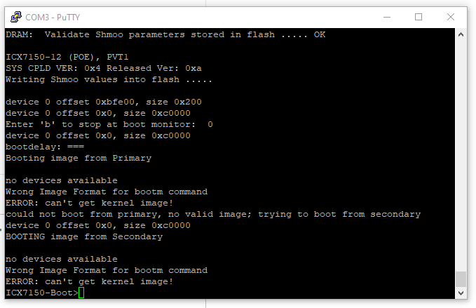

Hi @RobertCostigan
Greetings of the day!!!
Based on the troubleshooting done, your ICX-7150-C12P Switch is stuck in boot mode and you tried hard resetting and Software Recovery. However, the failure persists. This Switch unit Should be RMA (Return Merchandise Authorization) in simple words replacing it.

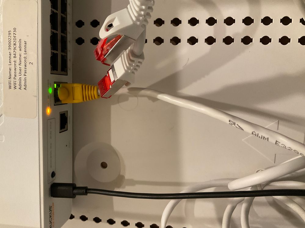

went through full recovery mode and putty still didnt work. usb connected from laptop to switch and ethernet same as well

Hi @RobertCostigan
Could you please let me know if you have configured the IP address for the Device Manager network adapters and performed 'setenv' commands as described in the guide? (Refer to the below screenshots)
If you have performed the above steps, please share the screenshots of the same.
Please check and let me know.
