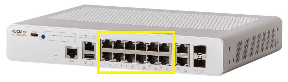

What you can do is to connect an Ethernet cable, plug it into the Ruckus switch and check the speed between ICX 7150 -C12 P and PC or any device
The best thing would be to check both ends of the Access Points since if something the cables  are not well connected in the plastic piece , this will affect the transmission speed.
You could also check on the Ruckus Switch if the port LEDs are amber or green in case the switch detects a problem.

I meant to check on the switch that the port is actually negotiating a gigabit speed. Colour means absolutely nothing.
Hi @Squozen
If there is any error ( speed or physical )  on the port  that goes to an end device the Switch can detected and put that link in to steady amber
Possible causes of errors that you should check and attempt to fix include:
  • External factors (such as faulty or loose cables, bad optics, and environmental electromagnetic factors).
  • Configuration issues (such as mismatch in duplex settings).
