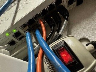

1. When your switch is connected to the outlet, do you observe any illuminated lights (amber or green)? Kindly describe which lights are visible. Additionally, please provide a photo showing the status of the lights and the full switch panel with cable connections to the switch ports.

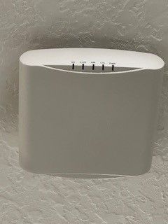

2. How many access points are currently connected to the switch? Please describe the status of the lights on the access points. Similarly, include a photo showing the access points' light status.

06-04-2025 09:12 AM
Hi @TriciaT
Thank you for your response and for sharing the details.
Based on the current LED status of the RUCKUS ICX-7150-C12P Switch, the device appears to be functioning normally. However, it is possible that the switch ports have entered a disabled state, which is likely preventing the Access Point from receiving power. To resolve this, the ports will need to be manually enabled via the command line interface.
Please refer to the following RUCKUS Lennar Knowledge Base self-help article for step-by-step instructions to address this issue:
https://community.ruckuswireless.com/t5/RUCKUS-Lennar-Support-Knowledge/NO-Power-on-Access-Points-an...
Feel free to reach out if you need any assistance during the process.

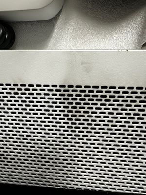

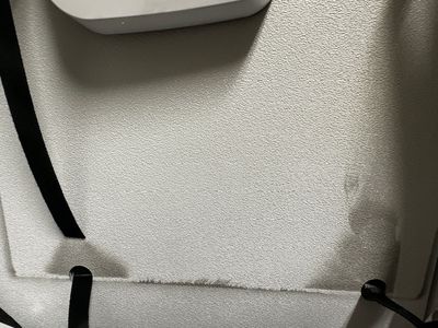

06-04-2025 04:36 PM
So I just noticed that there was black smoke as if something had surged and when I looked behind it the wall had smoke marks? How do we get replaced and who do we get to install?
