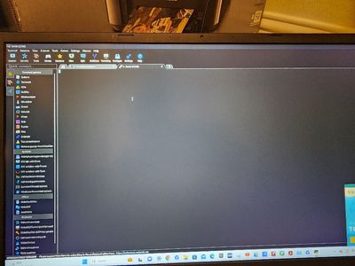

Hello.  I'm sorry that I'm having trouble.  I clicked "ok" for COM3.  I didn't get any prompts like "ICX7150-12 Router", just a blank screen.  Do I need to install putty if I already installed Mobaxterm??
I'm reading the instructions u sent me, but still lost.  You stated for me to log into "console CLI", in order to do that, do I need to download something else???????

Can I use Mobaxterm instead of putty since mobaxterm is already installed??? If yes, what do I need to click on?
Hi @YMM
In serial port dropdown select COM port with (Silicon Labs CP210x USB to UART Bridge (COM3) with speed 9600 and click on OK. Refer to the below highlighted screenshot. Check if you get any CLI prompt.
