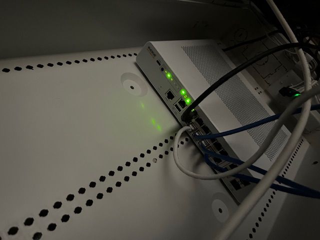

There is no power but the switch lights are all green. What is the next step?

2. Upon inspecting your switch while it's connected to the power source, do you observe any illuminated lights (amber or green)? Kindly specify which lights are active. For visual reference, please refer to the image below and provide a picture displaying the status of lights on your ICX-7150-C12P Switch, along with a comprehensive view of cable connections to the Switch ports.

As you can see there are only Green lights.
06-14-2024 12:34 PM
We did have a power outage and that is when we were having issues. I followed the steps to restart the switch and I had to do that about 9 times. The switch then was back to having all green lights but the Access Point had and continues to have zero lights on.

Hello @evillalp
Thank you for your response and for providing the information.
Based on the current status of the RUCKUS ICX-7150-C12P Switch's lights, it appears to be functioning normally. However, it's possible that the ports on the switch may have been disabled, leading to issues with transmitting Power over Ethernet (PoE) through them.
To address this issue, I recommend referring to the RUCKUS Lennar Knowledge Base self-help article linked below. This resource provides troubleshooting steps to resolve the issue:
Link to Knowledge Base Article:
Please follow the outlined process, and feel free to reach out if you encounter any difficulties or require further assistance.
