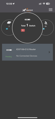

Ruckus APs are connected, but no internet. ISP wireless have been tested and is working fine. ICX Switch i sin Disconnected status, with status 'ICX Switch is Pending to join' with no IP.

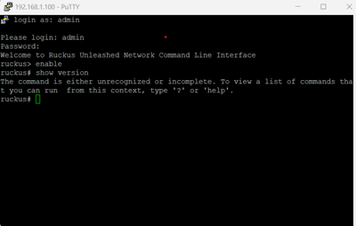

12-18-2023 07:59 AM
I am getting error in commands show version, show flash .
