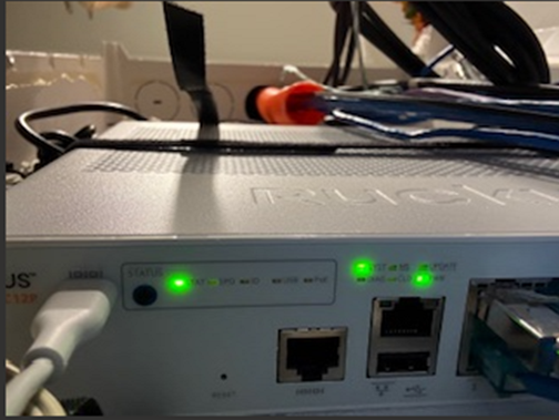

On your switch while it's plugged into the outlet, do you see any lights on? (Amber or green) Please let us know which lights are on. (Please refer to the below picture and share a picture of the same, showing the light status and the FULL Switch panel cable connections to the Switch ports)

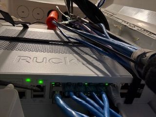

Here are the requested pictures. I hope these will suffice, the switch is mounted in a data closet, facing down, so getting good pictures can be difficult. Let me know if you need any additional information.
Hello @Lewthound ,

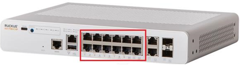

From the pictures you shared, it seems like the ethernet cable which is coming from the ISP’s (Internet Service Provider’s) Router or Modem/Router combo is plugged into the wrong port on the Switch panel. It must be plugged into any 1 in-12 ports as shown in the below screenshot.
1. Please unplug the ethernet cable and plug it into the correct port then reboot (unplug and plug from the power outlet) and try to connect to the Internet via Access Points.
It should be plugged into one of the 12 ports as shown in the below screenshot.

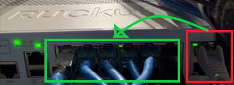

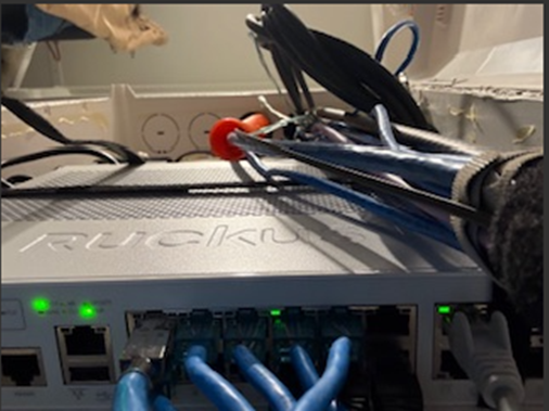

 With all that said, I moved the cable you requested from the RJ-45 uplink port to a RJ-45 downlink port. This is shown below, along with a picture of the access point.

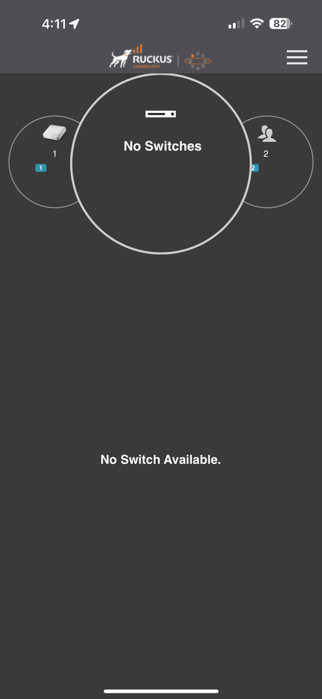

I can now connect to using the Unleashed app; however, the app doesn't see any switches and anything connecting to the access point's Wi-Fi cannot get to the internet. My phone was connected to the access point, and I had to turn off Wi-Fi to get to the internet.
So, what are our next steps to try and resolve this/these issues? The boot errors and the running of Routing code seems to be a problem that needs to be addressed. But I only know what I have gleaned from reading these forums. If you need any additional information, please let me know. Also, I appreciate your time and attention in helping to resolve this matter.
