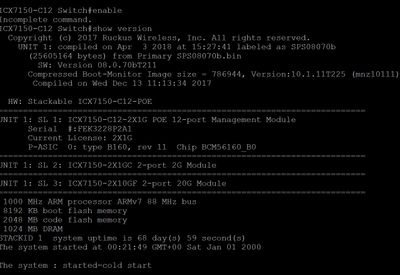

This issue may happen when the Switch runs on the Routing code (SPR). The Switch should run on the Switching code (SPS) to avoid these issues for Lennar home users. If the Switch boots up on the other partition (Due to a power outage/power spike) which may be running on a ‘Routing Code’ results in causing this issue. To check the same please follow the below process.
Please follow the below steps and help us with the queries:
ICX7150-C12 Router> OR
ICX7150-C12 Switch>
show version
show flash

Happy New Year! I was finally able to get a Windows PC. When I did the IP scan on the Windows PC, I was not able to find the Ruckus device. I followed the Putty directions and was able to connect the Ruckus to the Windows PC via a USB to USB-C cord.
When I first connected, I saw "ICX7150-C12 Switch>" in Putty. When I typed, "enable", there was a message about how there's no default password. I typed in what may have set the password. From then on, Putty always displayed, "ICX7150-C12 Switch#". I'm not sure if I accidentally messed up here, thought I'd share this detail. I've attached the screenshots from the 3 commands in the CLI (enable, show version, show flash).
Thank you for your help!
JJ
enable, show versionenable, show versionshow flashshow flash
