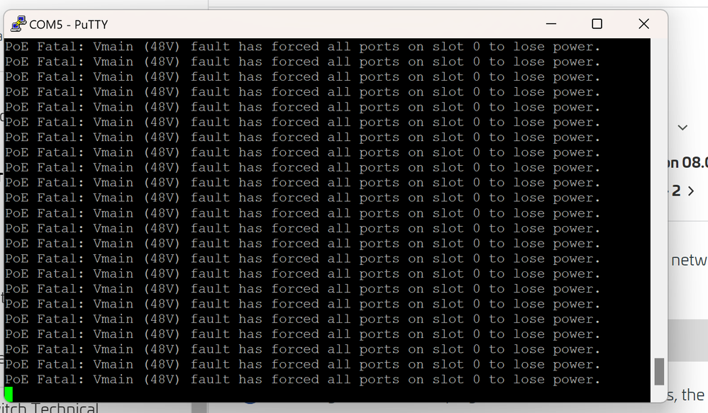

07-17-2024 03:06 PM
i am getting the following error message
07-18-2024 09:26 AM
Hi @J8yS1n_D1nM4r3
Greetings of the day!!!
Based on the troubleshooting conducted and our private chat discussion, it appears that your ICX-7150-C12P Switch is unable to obtain an IP address, and there is a persistent fatal error when attempting to console into it. These symptoms strongly suggest a hardware failure. In simpler terms, this Switch unit should be RMA (Return Merchandise Authorization) or replaced.
