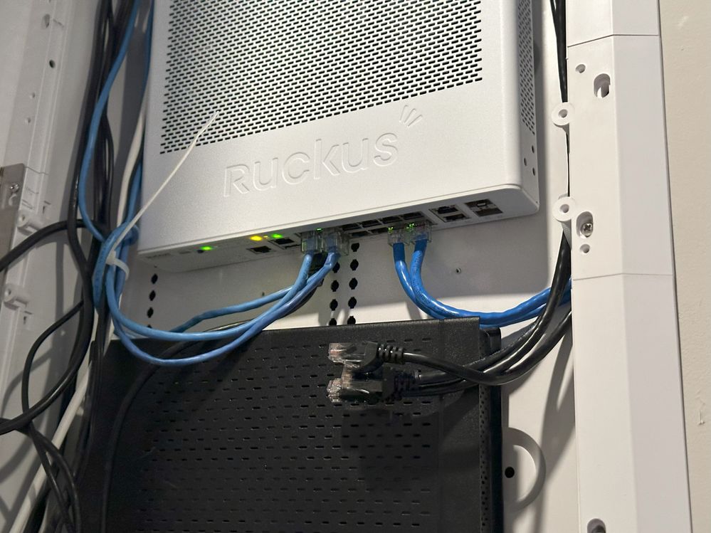

Ruckus 7150-c12p boot loop.. Cannot access CLI
It's been happening more often where the Ruckus 7150 switch goes into a boot loop. I cannot identify a direct cause... I am also unable to connect via telnet to the CLI. I just get a blinking cursor. I did try the reset by holding the reset button and reconnecting power.. The lights blinked amber until the next powercycle then it returned to it's past behavior.
Any further insight you might have is appreciated!

Hi @tjohnson825
As you mentioned and I can see from the screenshot you shared, there are lights on the PWR and SYST, if there is an amber/orange light on the "SYST" and a green light on the "PWR" on the Switch (as it is in the below picture). Meaning the Switch is stuck in the boot mode.
Basically, due to the power outage/ power spike, the switch went to a state that we call ‘boot mode’ that is not able to boot up properly. And this is the reason your RUCKUS ICX-7150-C12P Switch is unable to transmit power (PoE- Power over Ethernet) to the Access Points or on its ports.
As you mentioned that you tried reset, once again we will try to reset the Switch as described below VIDEO:
IF THE RESET IS NOT WORKING, PLEASE TRY TO RESET YOUR SWITCH MULTIPLE TIMES (Like 10-15 times) AS DESCRIBED ABOVE. As we have seen it working sometimes after trying multiple times in many cases. If the reset with a paperclip works, the SYST and PWR lights should turn GREEN.
IF RESET DOESN’T WORK: Please follow the below steps:
Please note, we must use ethernet cable (both ends RJ45 plugs) and USB to type C cable both together as described in steps 2 & 3 in the guide link.

Hi @tjohnson825
As per the case description, I understand that your RUCKUS ICX-7150-C12P rebooting frequently.
1. Was this working before or is it a new installation? If it worked before, was there any power outage before you started facing this issue?
2. On your switch while it's plugged into the outlet, do you see any lights on? (Amber or green) Please let us know which lights are on. (Please refer to the below picture and share a picture of the same, showing the light status and the FULL Switch panel cable connections to the Switch ports)
Please let me know the answers to ALL the above queries or let me know if you have any queries in this regard.

12-04-2023 01:16 PM
There was a power outage a week or two ago, but symptoms didn't start until Thursday... The switch operates on and off, restarting every 10-30 minutes...
12-04-2023 01:37 PM - edited 12-04-2023 01:55 PM
Oh and it worked fine up until Thursday Night into Friday morning... and to be clear the amber light blinks for about 3-5 min before the switch crashes... once it recovers it goes solid green...

Hi @tjohnson825
