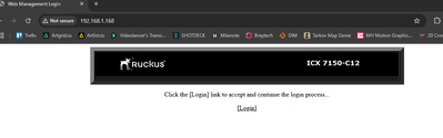

I was able to find the switch IP with my ATT Smart Home manager under the devices using the network. Tried plugging it in into a browser and saw the correct page to confirm it is the switch IP.

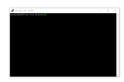

tried using the Putty login to access CLI via SSH, it did not work. Using Telenet did work.

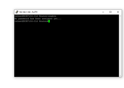

it said a password has not been assigned, what should I do here?
