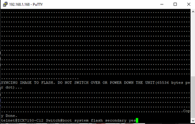

it seems to have frozen here

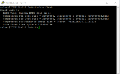

when I did show flash this is what I saw

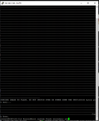

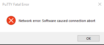

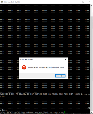

ICX7150-24P Router#boot system flash secondary yes (hit enter to accept the command: the switch will reboot)
I keep hitting return and nothing happens here
And now the network is completely offline.

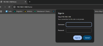

Additionally now when I try to go to the IP address I get this:
