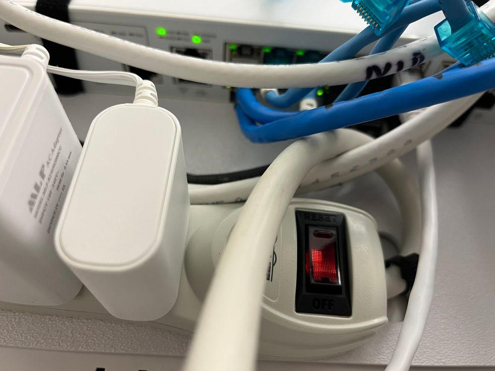

I included the best picture I can take. I really do not want to unmount this.
08-09-2024 09:17 AM
Hi @dtsteinb
Thank you for your response and the information provided.
Based on the pictures you shared, the light status and connections of the Access Points and the RUCKUS ICX-7150-C12P Switch appear to be normal.

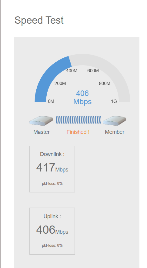

3. Additionally, perform a SpeedFlex test to measure the speeds between the Master and Member Access Points. Refer to the screenshot below for the SpeedFlex process.
Please provide the requested screenshots and test results at your earliest convenience.

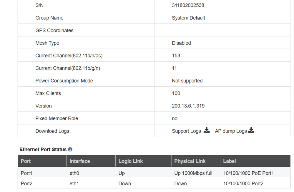

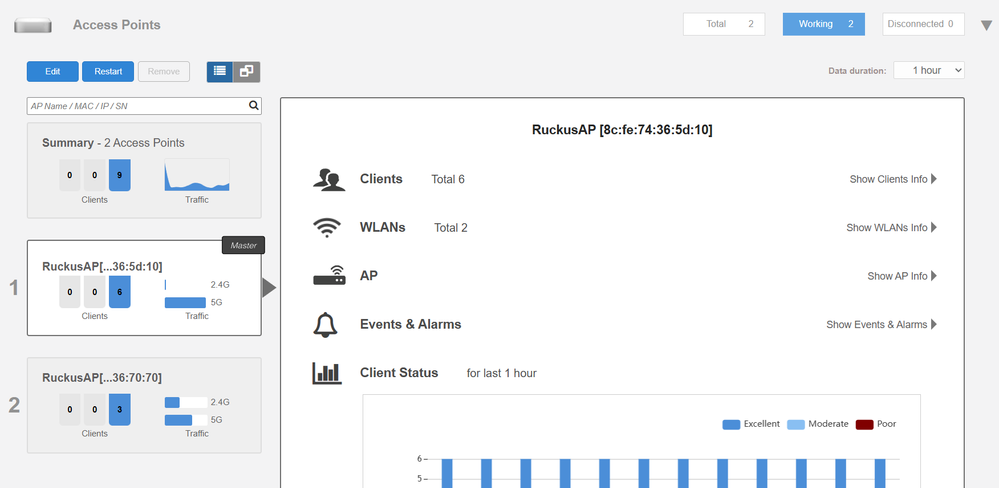

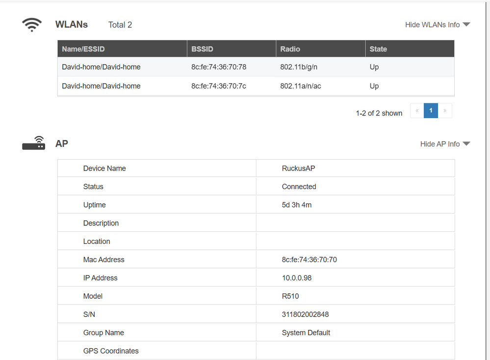

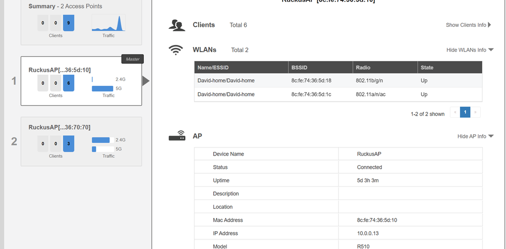

Hi @dtsteinb

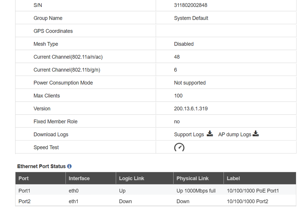

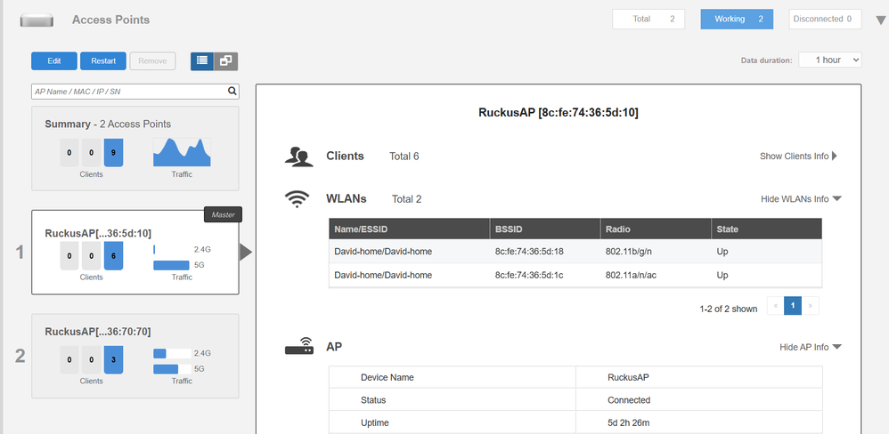

Please refer to the 2nd point from my previous post and send the same TWO screenshots for each AP. (Refer to the screenshots below)
08-09-2024 10:15 AM
I hope this is it
